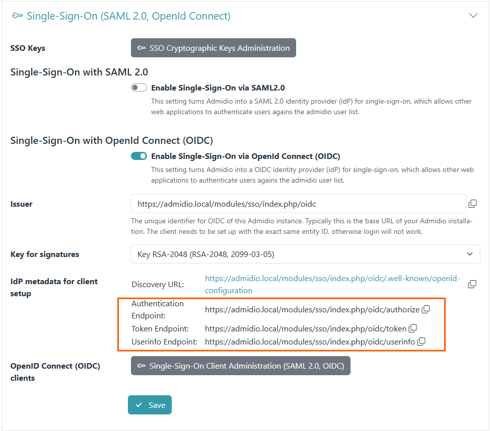

  1. The client (RP, GitLab in our case) needs to be set up with the data about the OpenID Provider (OP). Typically this is done via the metadata provided in the discovery URL of the provider. Otherwise one has to manually paste the endpoint URLs of the OpenID provider. Since Admidio provides those URLs with copy buttons in the preferences screen, even the manual configuration is rather straightforward.
  2. Admidio needs to be told about the client. In particular, the entity ID and the redirect URL must be given, and a custom-generated (random) secret must be copied to the client configuration.

It is now a good idea to keep two browser windows open so one can easily select and copy the settings. Admidio even provides little “copy” buttons/icons to copy the various settings to the clipboard for easy pasting into GitLab's configuration.

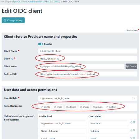

Now, return to Admidio's SSO preferences page, go to the “Single-Sign-On Client Administration” (the button right below the endpoint URLs and above the “Save” button), and create a new client.
  1. The Client Name is the label of the client in Admidio's client list, it can be anything you like.
  2. The “Client ID” and “Client Secret” in Admidio have to match exactly the “clientID” and “clientsecret” entries in GitLab's configuration. The ID is typically the client's URL, i.e. https://[YOUR_GITLAB]/. The client secret is randomly generated and must be copied exactly to the GitLab configuration, as it will serve like a password. Admidio will create one and allow it to be copied to the client. Afterwards it is only stored as a hash in the database and can not be recovered any more. However, one can create a new Client Secret in Admidio and copy that to the client's configuration.
  3. GitLab's redirect URL is the Special:PluggableAuthLogin page, i.e. https://[YOUR_INSTALLATION]/index.php/Special:PluggableAuthLogin. Enter that URL in Admidio's client config.

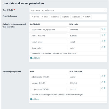

  4. Enter the scopes you used in GitLab's config and make sure that Admidio's config matches it. At least openid must be included (Admidio will implicitly add it). If groups/roles are supposed to be used for access permissions, the “groups” scope also must be included in both GitLab's and Admidio's scope setting and the roles included as an OpenID claim. (The groups mapping that Admidio offers is optional, one can also send all groups verbatim without mapping. This can be achieved by checking the checkbox below the mapping table in Admidio).
This is a typical configuration of the GitLab OpenID client in Admidio:
The clientID and the client secret in the Admidio client page and GitLab's config/gitlab.rb have to match exactly. Similarly, the scopes should coincide, otherwise not all desired profile fields will be transmitted. To make use of the group mapping in GitLab (see the Gitlab documentation for details), make sure to include the 'groups' scope in Admidio and GitLab, and map the 'Roles - roles' Profile Field to an OIDC claim.

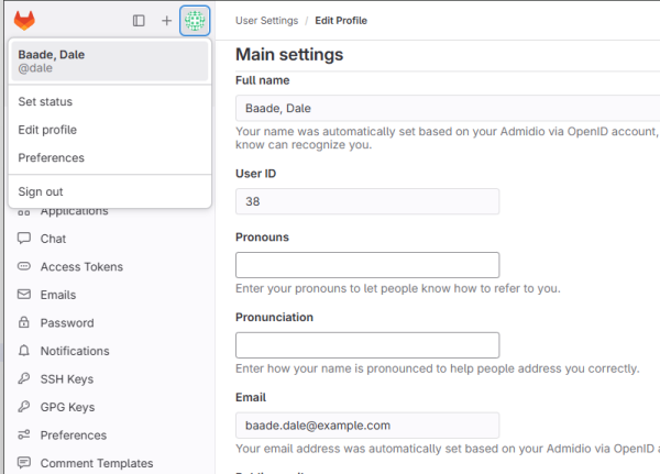

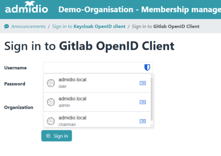

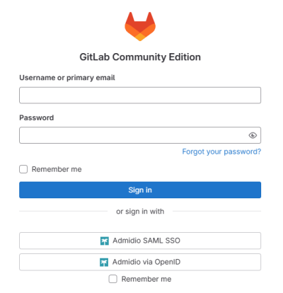

Admidio and GitLab should now be set up to use Admidio for logging in to GitLab. If you log out of GitLab (or open a new incognito browser window) and try to log in again, the login form with have an additional button (with the label given in the config file) to initiate an OpenID login. If you click it, you will be shown the Admidio login screen (if you are not already logged in) and then redirected back to GitLab after successful login.
