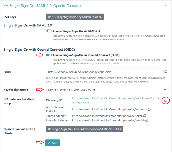

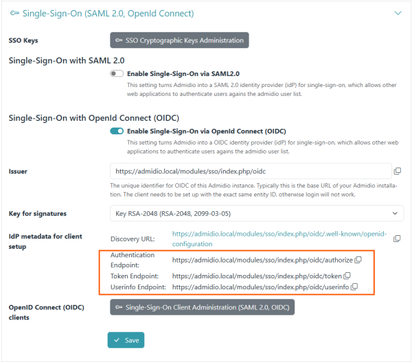

  1. The client (RP, DokuWiki in our case) needs to be set up with the data about the OpenID Provider (OP). Typically this is done via the metadata provided in the discovery URL of the provider. Otherwise one has to manually paste the endpoint URLs of the OpenID provider. Since Admidio provides those URLs with copy buttons in the preferences screen, even the manual configuration is rather straightforward.

It is now a good idea to keep two browser windows open so one can easily select and copy the settings. Admidio even provides little “copy” buttons/icons to copy the various settings to the clipboard for easy pasting into MediaWiki's configuration.

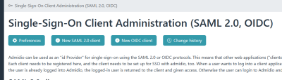

Now, return to Admidio's SSO preferences page, go to the “Single-Sign-On Client Administration” (the button right below the endpoint URLs and above the “Save” button), and create a new client.

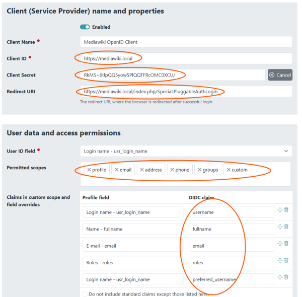

  1. The Client Name is the label of the client in Admidio's client list, it can be anything you like.
  2. The “Client ID” and “Client Secret” in Admidio have to match exactly the “clientID” and “clientsecret” entries in MediaWiki's configuration. The ID is typically the client's URL. The client secret is randomly generated and must be copied exactly to the MediaWiki configuration. The Client Secret should be a random string and will serve like a password. Admidio will create one and allow it to be copied to the client. Afterwards it is only stored as a hash in the database and can not be recovered any more. However, one can create a new Client Secret in Admidio and copy that to the client's configuration.
  3. MediaWiki's redirect URL is the Special:PluggableAuthLogin page, i.e. https://[YOUR_INSTALLATION]/index.php/Special:PluggableAuthLogin. Enter that URL in Admidio's client config.
  4. Enter the scopes you used in MediaWiki's config and make sure that Admidio's config matches it. At least openid must be included (Admidio will implicitly add it). If groups/roles are supposed to be used for access permissions, the “groups” scope also must be included in both MediaWiki's and Admidio's scope setting and the roles included as an OpenID claim. (The groups mapping that Admidio offers is optional, one can also send all groups verbatim without mapping. This can be achieved by checking the checkbox below the mapping table in Admidio).

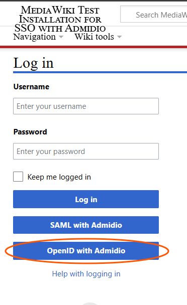

This is a typical configuration of the MediaWiki OpenID client in Admidio:
The clientID and the client secret in the Admidio client page and MediaWiki's LocalSettings.php have to match exactly. Similarly, the scopes should coincide, otherwise not all desired profile fields will be transmitted. To make use of the group mapping in MediaWiki, make sure to include the 'groups' scope in Admidio and Mediawiki, and map the 'Roles - roles' Profile Field to an OIDC claim.

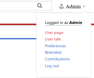

To assign admin (sysop) rights to an OpenID account, the group 'sysop' should be assigned in Admidio's client config and MediaWiki's groupsyncs must exclude 'sysop' from the locally managed groups.

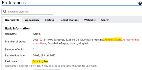

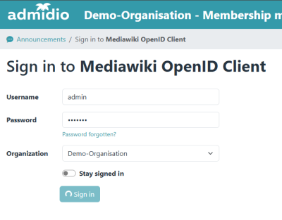

Admidio and MediaWiki should now be set up to use Admidio for logging in to MediaWiki. If you log out of MediaWiki (or open a new incognito browser window) and try to log in again, you will be shown the Admidio login screen and then redirected back to MediaWiki after successful login. If groups are properly set up and mapped, MediaWiki groups will also be assigned, even admin rights through the OIDC group 'sysop'.
