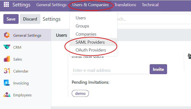

First, install the Authentication OpenID Connect (auth_oidc) app in Odoo:
It is now a good idea to keep two browser windows open with Admidio and Odoo's configuration so one can easily select and copy the settings. Admidio even provides little „copy“ buttons/icons to copy the various settings to the clipboard for easy pasting into the Odoo configuration.

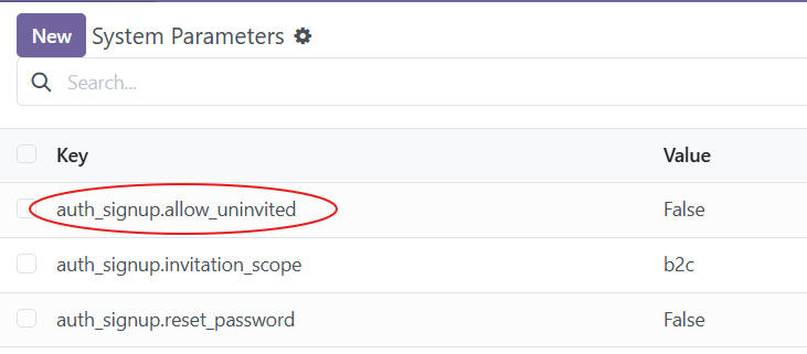

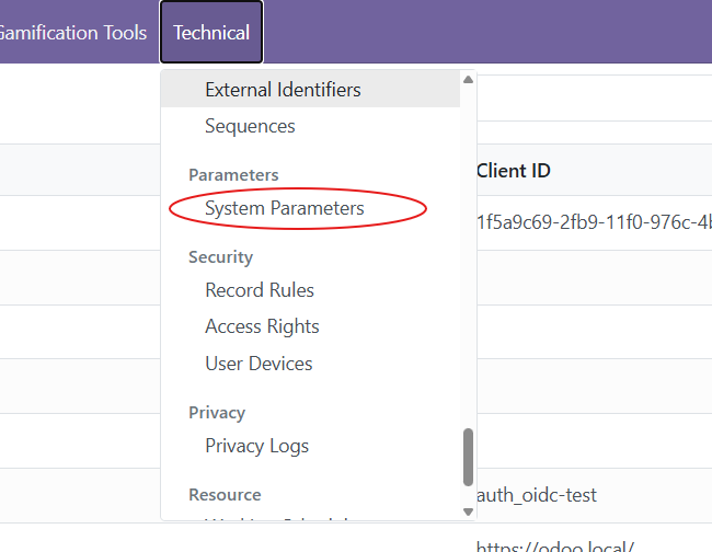

Odoo can automatically create a new user when a new account logs in using OpenID Connect through Admidio. This functionality is provided by the auth_signup plugin, which must be activated and configured. In developer mode, go to „Settings“ → „Technical“ → „Parameters“ ⇒ „System Parameters“ and create a new key auth_signup.allow_uninvited with value 'True'.
This settings causes the „Don't have an account?“ signup link to appear in the login form, and it will allow signup by anyone. However, in my tests, enabling this setting also enabled automatic account provisioning with OpenID Connect.
