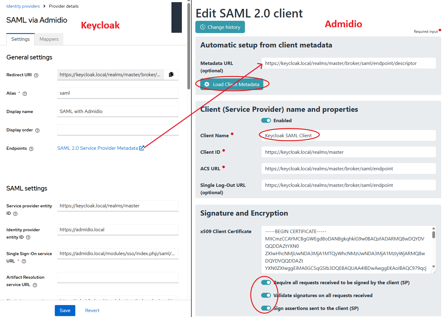

To add Admidio as an Identity Provider to log into Keycloak, go to your desired realm, choose “Identity Providers” on the left and add a new “SAML v2.0” Provider.
Keycloak supports auto-configuration, so copy the SAML Metadata URL from Admidio's preferences and paste it into the “SAML entity descriptor” field. Keycloak will load the SAML IdP configuration from Admidio and populate all fields.
After clicking “Add”, the SAML Provider is saved in Keycloak and can be further configured.
It is now a good idea to open Admidio in a second browser window and configure Keycloak and Admidio in parallel.
Copy the Metadata Url from Keycloak, paste it into the corresponding input field at the top and click “Load Client Metadata”. This should load all settings from Keycloak and pre-fill the following fields correctly. Only the Client Name needs to be entered. Choose any name to clearly identify the client in the list of SAML clients. There is no functionality depending on the name, but the name will be displayed in the login form.
It is also a good idea to require requests to be signed, and to sign all messages. Choose whichever level of security (request signing without requiring, require signing, or even encrypting all messages) fits you. You only need to ensure that the settings in Admidio and Keycloak are be consistent.
