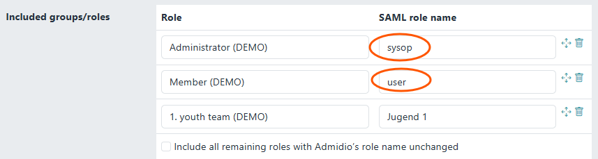

To map Admidio groups/roles to MediaWiki groups, one can either use the group mapping of MediaWiki (which I have not been able to correctly set up), or provide the desired group names directly in Admidio. MediaWiki uses serveral internal group names to assign elevated permissions: 'sysop' for admin rights, 'suppress' for users that can block users and administrate page revisions, 'bureaucrat' to edit users, 'users' for normal users, 'bot' for bot processes, etc. One can assign admin or other elevated rights by mapping an Admidio role to one of those reserved role names (and later setting up the automatic group assignment in MediaWiki, see below):
One can also check the box to include all Admidio groups in the SAML assetion. This will cause Admidio to send all groups to MediaWiki. Groups that have no particular rights assigned will be assigned to the user but will not have any effect.

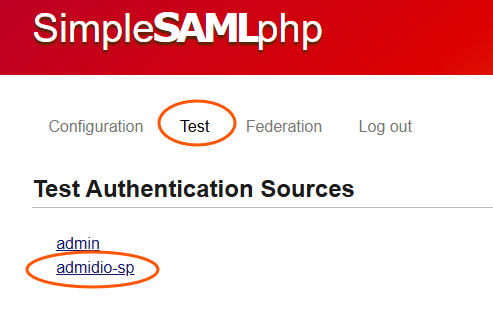

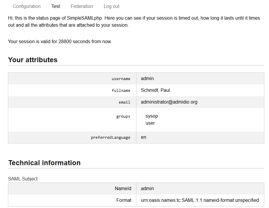

Admidio and SimpleSAMLphp should now be set up to use Admidio for logging in to SimpleSAMLphp. Switch back to the SimpleSAMLphp admin screen and go to the “Test” tab. Click on “admidio-sp” (the array key used in config/authsources.php for the Admidio IdP). You will be redirected to Admidio's login form.
After logging in with a user from Admidio, you should be logged in to SimpleSAMLphp.
