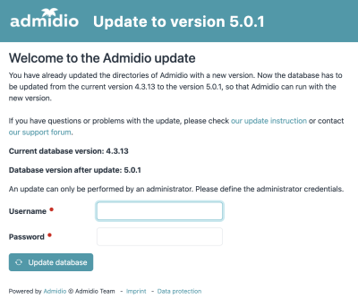

  2. If you created a backup in step 1, you can now open Admidio in your browser at ‘'www.example.org/admidio/’' and you will be redirected to the update page.
    If the update page does not open automatically, you can access it directly via the following URL: ‘'www.example.org/admidio/install/update.php’'.
  3. The following page will now appear, where you must confirm the update again. If the database has already been updated, this will be indicated accordingly. To prevent anyone else from performing the update, you must enter the login details of a webmaster. Then click on Update database and the database will be updated to the new version. Wait with further actions in the browser until the confirmation appears that the update has been successfully completed. This can take up to 4 minutes.
    :!: If the update has failed, you can restore your backup and, after clarifying the cause, restart the update or continue using the previous version for the time being. In the event of more serious problems or if you do not have a backup, it is still possible to restore your previous version.
Admidio has now been successfully updated and you can now work with the new version.
