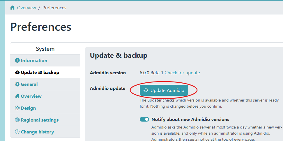

  2. Open Preferences → System → Update & backup and click Update Admidio. (Admidio 4.x and 5.0 do not have this button yet: see Add the updater for Admidio 4.x and 5.0 below.)

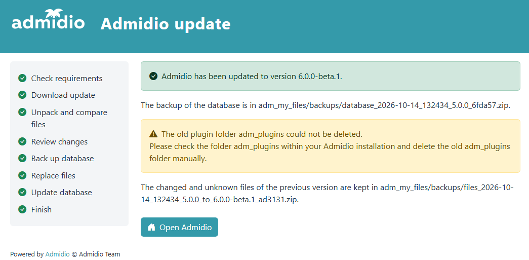

If there are any warnings or problems, the final page will clearly indicate it (see Finish and If something goes wrong). It also shows the locations of the file and database backups.

Click Update Admidio (see Notice that an update exists). The updater opens on a page of its own. On the left you see the steps of the update:

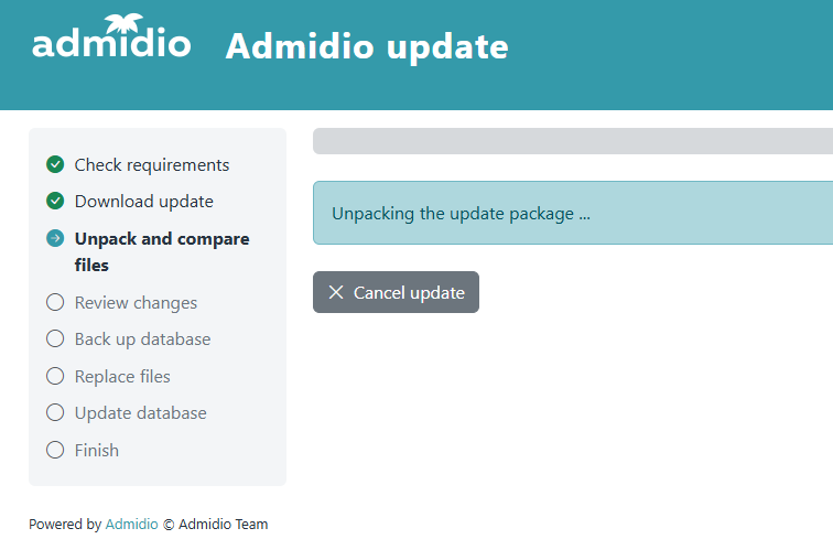

  1. Check requirements
  2. Download update
  3. Unpack and compare files
  4. Review changes
  5. Back up database
  6. Replace files
  7. Update database
  8. Finish

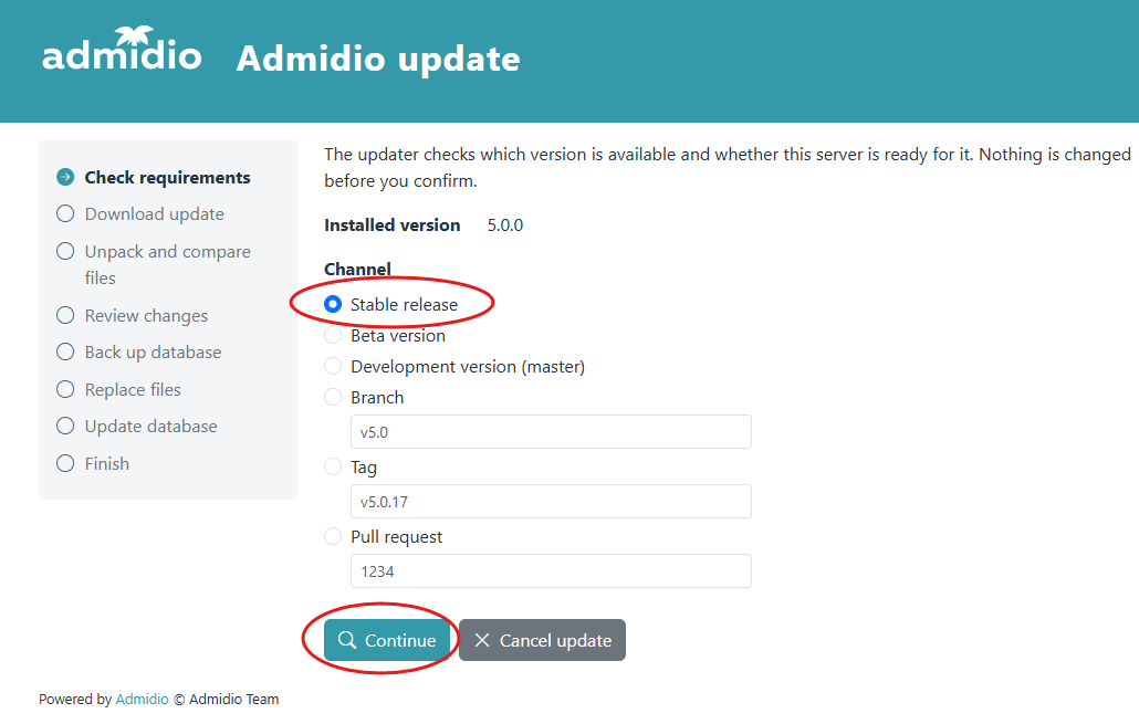

The Update & backup preferences Choosing the release channel
Developers can choose a development version instead of the stable one (only with debug mode switched on, see the questions at the end). For normal installations, only the stable version is offered.

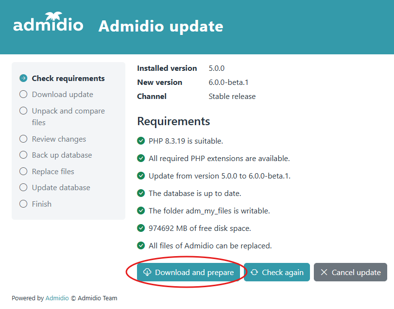

Check requirements
The updater checks the new version and your server. Every line is either green (ok) or tells you what is missing. Typical messages:
Message What to do
„Version X needs at least PHP 8.2, but the server runs PHP Y.“ Switch the PHP version of your hosting to 8.2 or newer, then click Check again.
„These PHP extensions are missing: …“ Enable them in your hosting panel or ask your provider.
„The web server cannot replace files in: …“ Fix the file permissions of the folders named there (the web server user must be allowed to write), then Check again.
„The update needs about N MB of free disk space …“ Free some space, then Check again.
„The database has version X, the files have version Y. Complete the database update (install/update.php) first.“ Open install/update.php in your Admidio folder and finish that update first.
„Version X needs at least Admidio Y, but Z is installed. Update to Y first.“ Update to the version named there first, then run the updater again.
„The folder adm_my_files can be reached from the internet …“ Protect adm_my_files in the configuration of your web server. The update keeps copies of your database and files there. With Apache, Admidio creates an .htaccess file; with nginx you need a rule of your own. This is a warning, not an error.
Errors (red) stop the update; warnings (yellow) do not. If all is well, click Download and prepare. Nothing has been changed on your site so far, and Cancel update removes everything the updater has created.
The requirements check

After the download the updater unpacks the release and compares its files with yours.
Unpacking the release

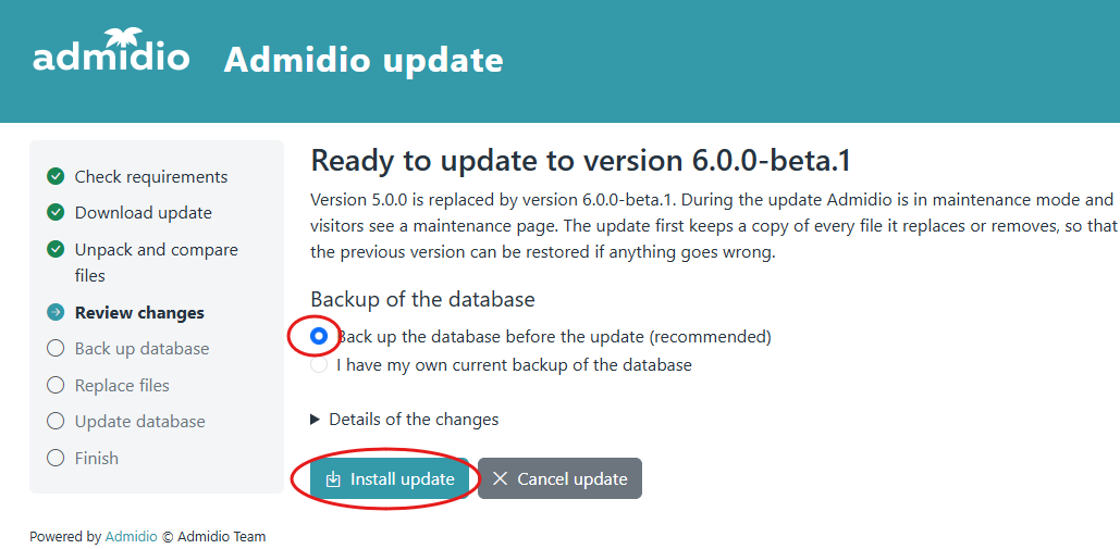

The page „Ready to update to version X“ tells you what will happen:
Then you choose the backup of your database:
Overview of the changes and choice of the database backup
Click Install update when you are ready. From here on the site is in maintenance mode. If something fails from here on, see If something goes wrong.

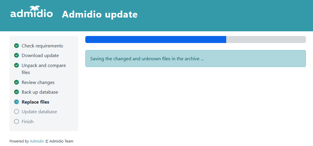

What happens now
The updater runs through the remaining steps without further questions:
  1. Maintenance mode goes on, and the database is backed up.
  2. Every file that is replaced or removed is copied away first, then the new files are installed and checked again.

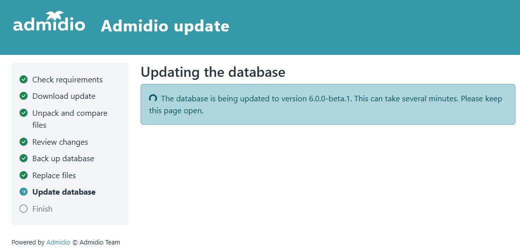

  3. The database is updated. This can take several minutes for a large installation. Keep the page open.
  4. Maintenance mode goes off.
If your server cuts off a long request, the page keeps asking the server until the database update is really finished.
Backing up and replacing the files Updating the database

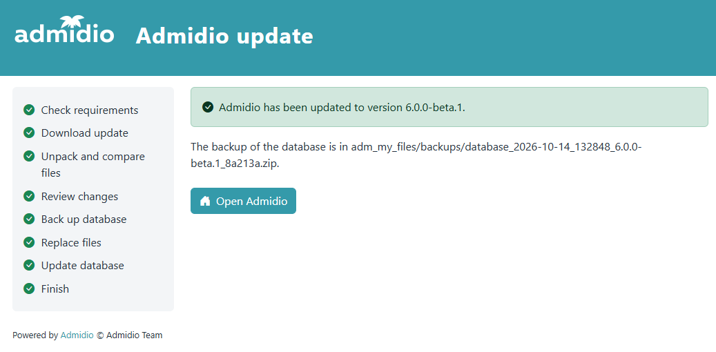

The page says „Admidio has been updated to version …“. It lists
The log of the update is saved in adm_my_files/logs/core-update_<date>_<from>_to_<to>.log.
Click Open Admidio. Try the start page, the login and one or two modules. Usually you stay logged in; if not, log in again.
The update is finished
If there are warnings or problems, the final page says so clearly, with the locations of the backups and notes for you to act on.
The final page with a warning
