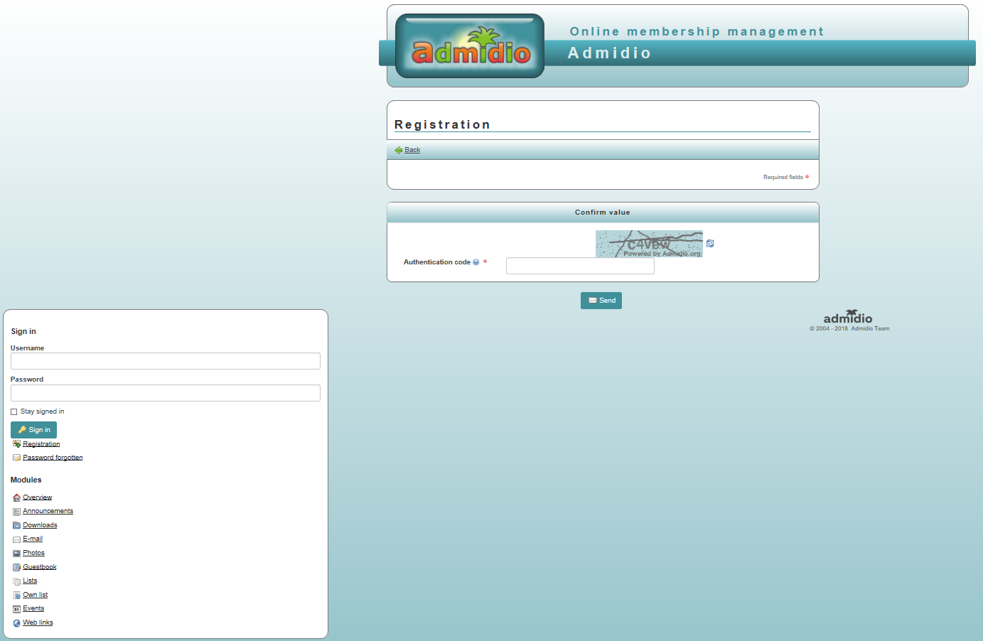

Hello Everyone,
I installed admidio in AMMPS and subdomain to test functionalities.
I noticed below :-
1) registration form doesn't show up any field and
2) side bar goes in to bottom left..
3) In previous version, there used to
>Preference>General>Registration> Dropdown (Inactive,Quick Registration,Advance registration)
which is no more instead we just have "enable registration". How to get this work in the latest version?
can someone help/update me to sort this out?

Re: admidio-3.3 register screen with no fields and sidebar alignment
Looks like the same problem as here: viewtopic.php?f=3&p=27893
Please enable the debug mode and look in the logs if there is a useful hint

What i have noticed is, this is unchecked in all the profile fields "Field is displayed during registration".
if i create a test category and add profile field with this option checked ""Field is displayed during registration". Registration form works display works as normal..
if this is something was not part of major change in this upgrade then can i request to roll back as it was..otherwise people will end up with broken registration after upgrade. Also upgrade need to be smooth making sure doesn't break existing stuff etc..

registration is broken in admidio-3.3 and there is no more drop down available with in Preference > registration.

Beiträge: 6351
Hi Amitabh,
I found the problem and fix it: https://github.com/Admidio/admidio/issues/742
We will release a new version within the next days. You could not create Username/password/confirm they will be generated automatically.
You can fix the problem for yourself if you check the ckeckbox for registration for at least one field in the field configurator.

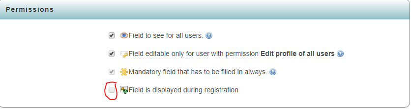

This check box
is grayed out and unable to check this box for fields such as First Name/Surname/Email. Please refer below screenshot.
admidio - registration field.PNG (13.12 KiB) 18973 mal betrachtet
I tried selecting check box for field "Postal Code" & i get back the registration form with postal code & i get back registration form with username and password..but this is still a bug as check box to be enabled for these fields First Name/Surname/Email to make things work.
Thanks,
Amitabh
Beiträge: 6351
Ok, than You Must wait For the next Version.
