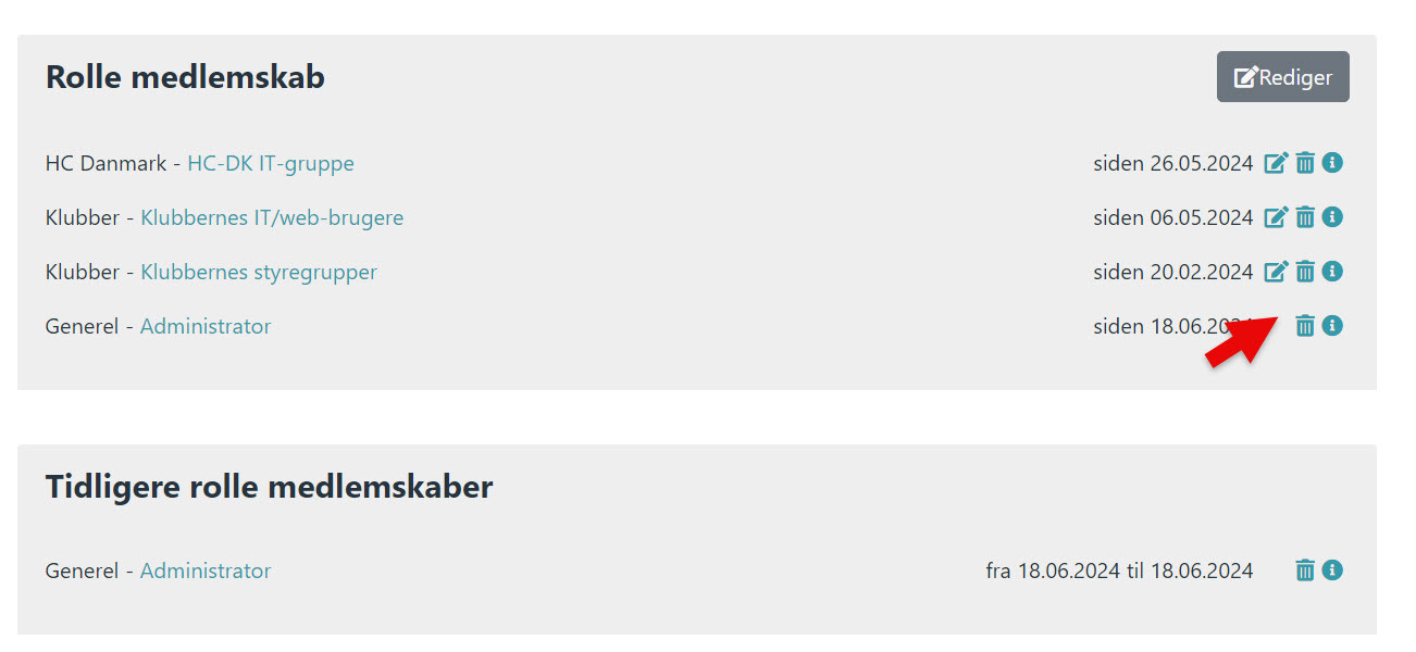

Hi.
We have 5 administrators.
I'm trying to remove one (not myself), but it just doesn't work.
It shows as removed,but is still present in the list of administrators.
The screendump shows the situation after removal.
I then tried in the administrator group to unselect membership for the member, still didn't work.
Then I selected both the group and set as leader / manager for the member.
Then, after unticking membership of administrator group, it finally worked.
So, to remove one from administrator group, use the group assignments.
Then select both the group and set as leader / manager for the member in question.
Then unselect the group assignment.
I guess it shouldn't work that way, so any solutions?
BR Johnny

Hi Johnny,
the problem was the beginning of the administrator membership yesterday. If it's starts earlier than the removement works.
I fixed the problem and you could replace the extracted file in adm_program/system/classes

Hi Fasse.
Thanks, it works
