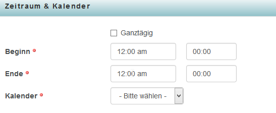

i think there is something going wrong. See screenshot or demo.
In date field is am until u click it.
2015-10-16 20_36_44-Demo-Organisation - Termine anlegen.png (6.47 KiB) 24982 mal betrachtet

Bullseye hat geschrieben:i think there is something going wrong. See screenshot or demo.
This was because you set g i:a in the date format field and not the time field.

fasse hat geschrieben:
Ah ok. But if u do that, an error mesage should thrown, that u are using wrong format
