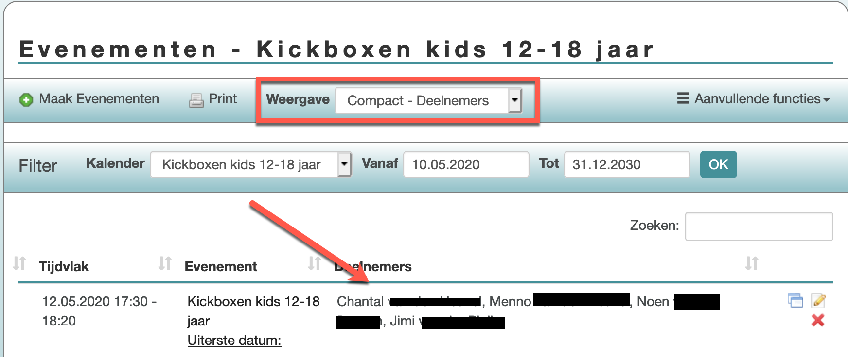

When a participant subscribe to a event with limited room, you will see the number of participants with +1 and in de events overview you will see the participants name as administrator.
When a participant cancel's the subscribtion the subscribers number will be lowered with -1 as expected.
But... when we do the event overview with the participants, we still see there name as subscribed.

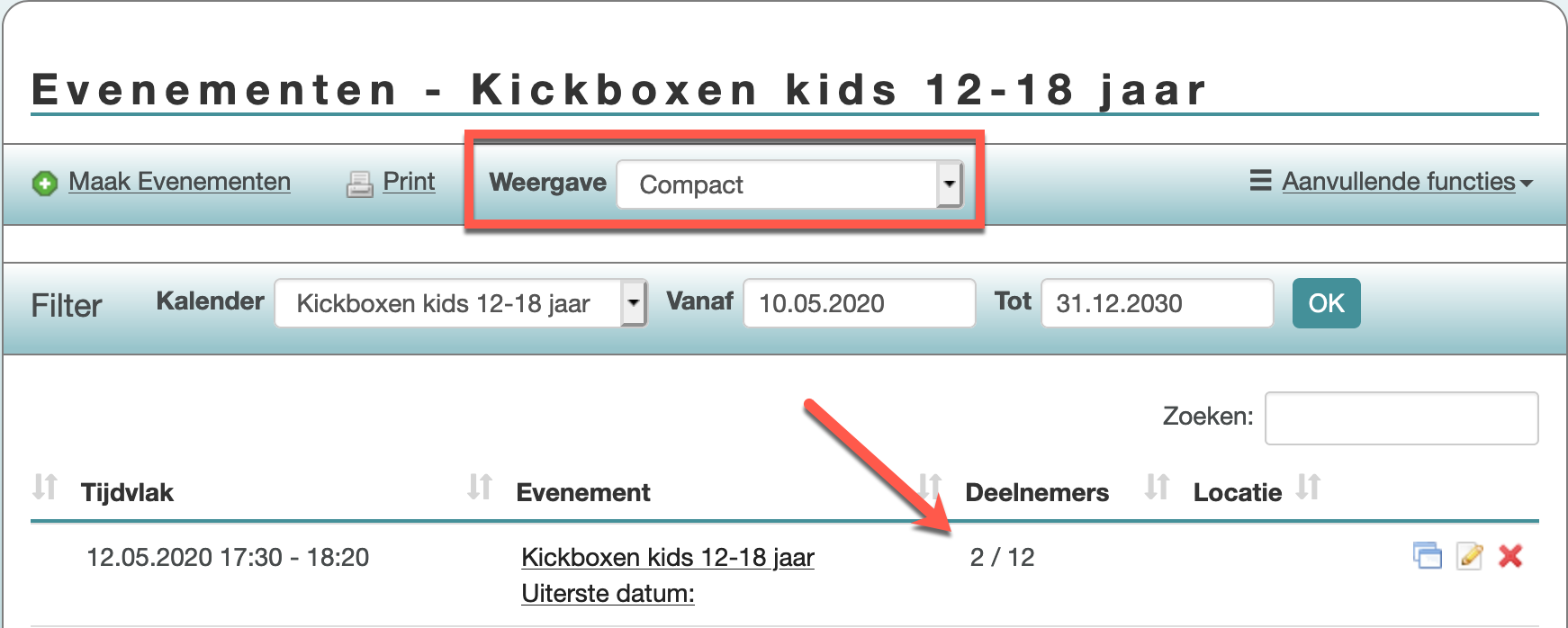

you can view the screenshots with the following links;
Image with participants number.
Image with event overview, where you see the subscribed as canceled participants

When a member subscribe to a event with the option Participate, in the Detailed view you wil see that the members will upper with +1 members.
If you look in the Compact - Members view you will see the name of the member(s) which pariticpate to a event.

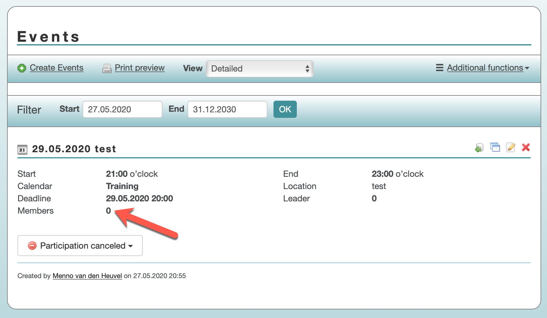

Then the member logs in and then cancels his participation the Members number in the overview will lower with -1 members.

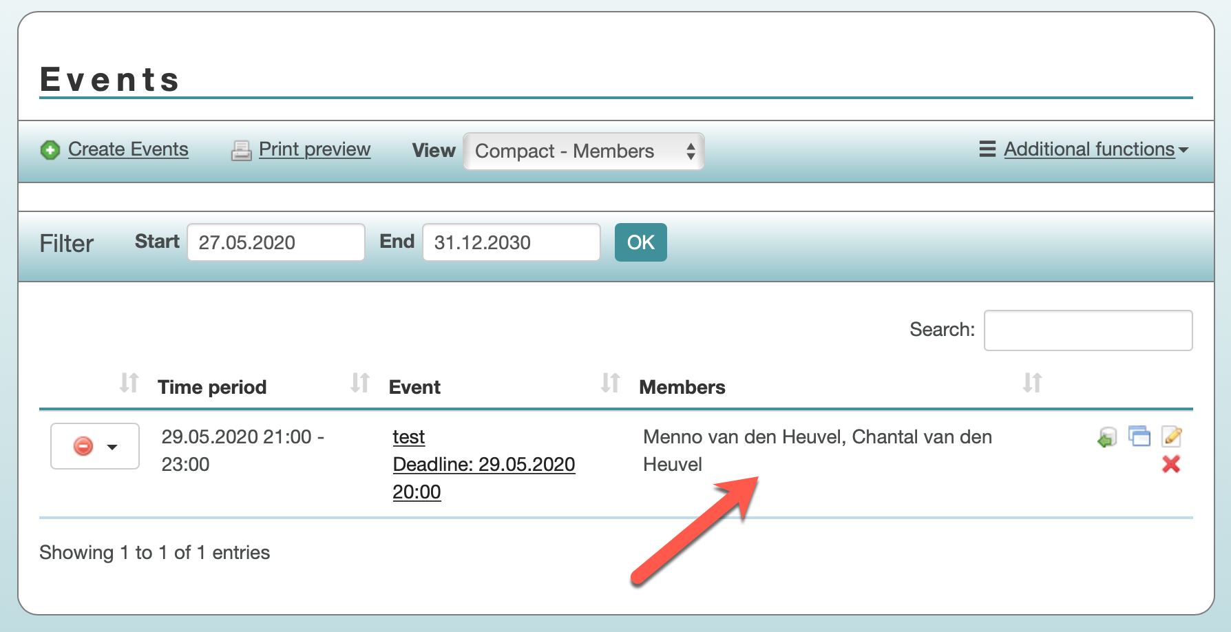

But, when you go to the view Compact - Members you still will see the participant name at the event, even when the Members number is 0.
When a member even just only cancel his participation, his name is added.
- Here you see names, even with 0 members
- Admidio2.png (196.66 KiB) 14269 mal betrachtet
- Here you see 0 members
- Admidio1.png (203.51 KiB) 14269 mal betrachtet
