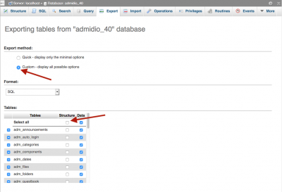

- For this purpose, you should, as with all adjustments to the database, before making a full backup of your Admidio database. If you run in trouble you can rely on this backup.

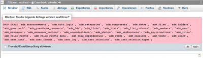

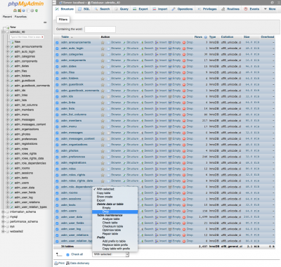

- Next, you should now delete all existing Admidio tables in the database with an appropriate program (in this documentation phpMyAdmin). For this you mark the appropriate tables and choose entry Delete.

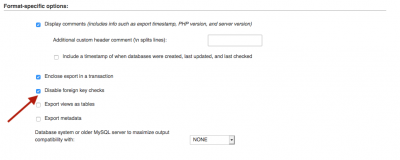

- In the next step we now import the backup from point 1 again. This is also done with Import.
