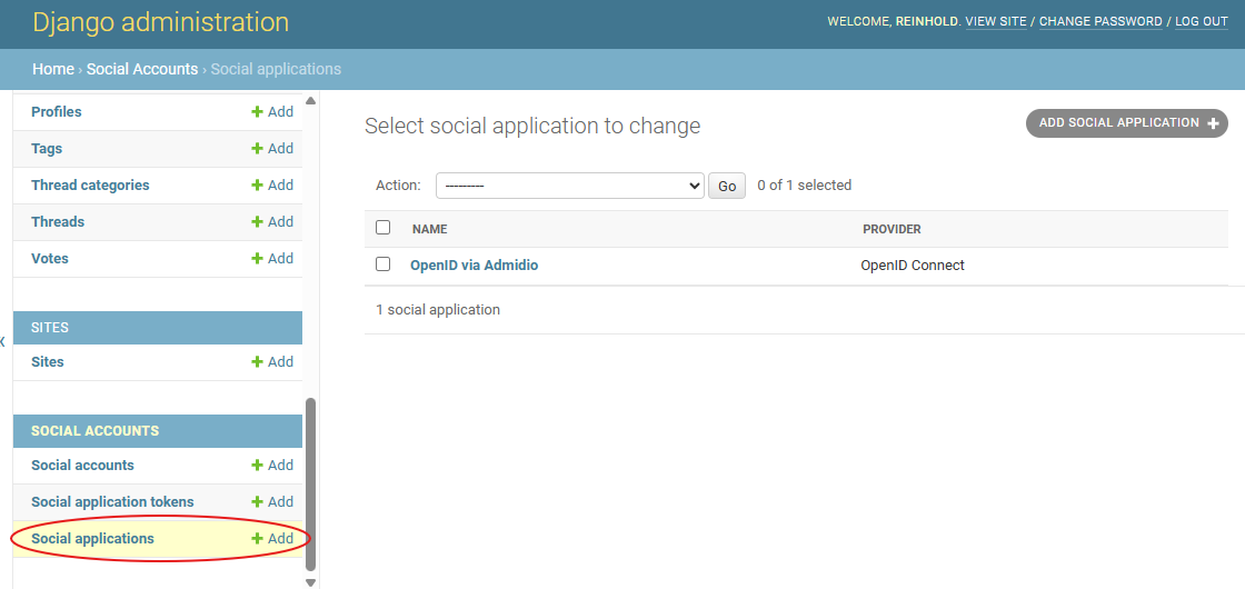

- To set up the OpenID provider with the admin GUI, go to the Django admin backend
https://[YOUR_MAILMAN]/admin/and log in as Mailman admin.

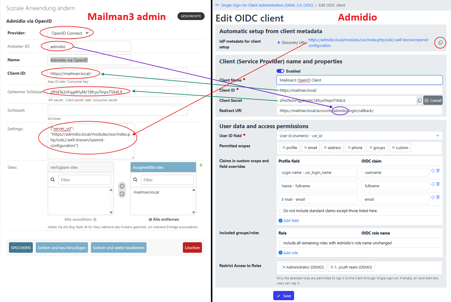

- Go to the Accounts section and select “Social Apps”, where you can add a new OpenID provider through Admidio (see below where the individual settings can be copied from):
- It is now a good idea to keep two browser windows open with Admidio and Mailman3's configuration so one can easily select and copy the settings.
Setting up the Client (RP) in Admidio
The settings in Mailman3's and Admidio's OpenID setup need to match. Most of the settings can be copied over from Admidio to Mailman3 or vice versa:
- The Client Name is the label of the client in Admidio's client list, it can be anything you like.
 - The “Client ID” and “Client Secret” in Admidio and Mailman3 have to match exactly. The ID is typically the client's URL, although some clients allow any unique identifier. The Client Secret should a random string and will serve like a password. Admidio will create one and allow it to be copied to the client. Afterwards it is only stored as a hash in the database and not be recovered any more. However, one can create a new Client Secret in Admidio and copy that to the client's configuration.

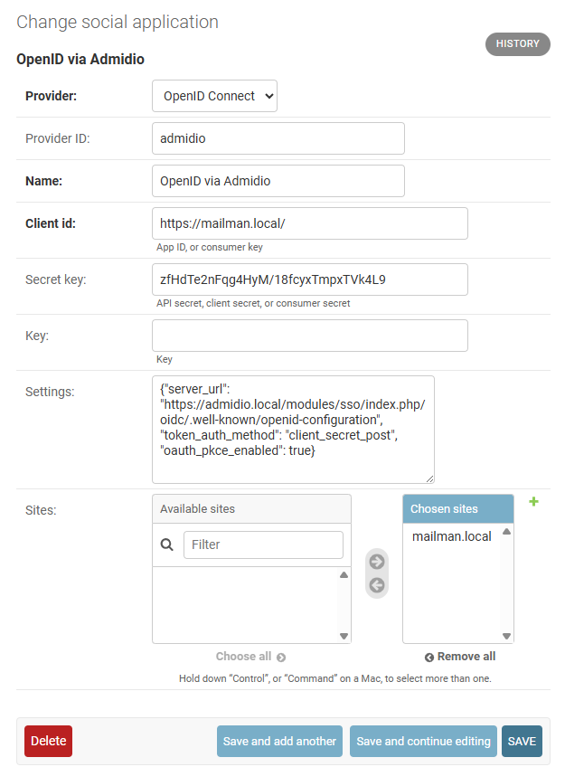

 - Copy over the Discovery URL from Admidio into Mailman3. Admidio provides little “copy” icons for this. The URL needs to be entered in the Settings: field in the form:
{"server_url": "[DISCOVERY_URL]"} - Enter the scopes you desire in the Mailman3 config and make sure that Admidio's config matches it. At least openid must be included (Admidio will implicitly add it).
 - In mailman, choose a provider_id, which will be part of the redirect URL that needs to be entered into Admidio. The Redirect URL for Admidio is:
https://[YOUR_MAILMAN]/accounts/[PROVIDER_ID]/login/callback/

Configuration in settings_local.py
Rather than the graphic setup in django's admin backend, one can also setup the OpenID provider in Mailman's settings_local.py. The corresponding entry to the above example is:
SOCIALACCOUNT_PROVIDERS = {
    "openid_connect": {
        "OAUTH_PKCE_ENABLED": True,
        "APPS": [
                "provider_id": "admidio",
                "name": "OpenID via Admidio",
                "client_id": "https://mailman.local/",
                "secret": "zfHdTe2nFqg4HyM/18fcyxTmpxTVk4L9",
                "settings": {
                    "server_url": "https://admidio.local/modules/sso/index.php/oidc/.well-known/openid-configuration",
                    "token_auth_method": "client_secret_post",
                    "oauth_pkce_enabled": True,
In this example, the pkce and token_auth settings are optional. For a list of all available options see the django-allauth documentation.

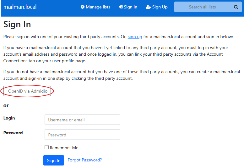

Admidio and Mailman3 should now be set up to use Admidio for logging in to Mailman3. If you log out of Mailman3 (or open an incognito browser window) and try to log in again, you will be shown the Admidio login screen and then redirected back to Mailman3 after a successful login.

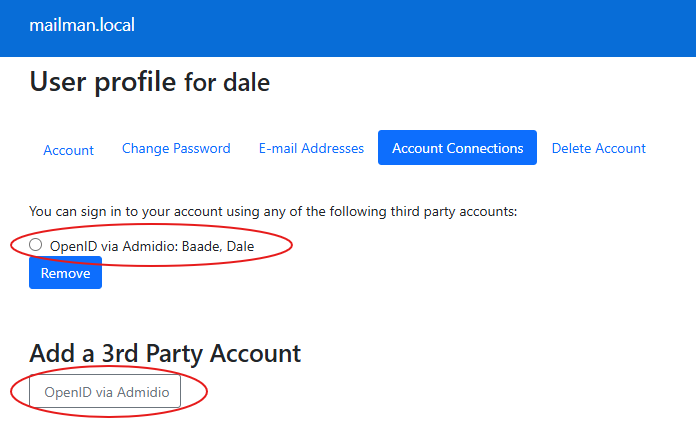

On a successfull login, the connection to the OpenID account will be stored in the user profile. For existing Mailman users, one can connect the mailman account with an OpenID account in the profile, too:

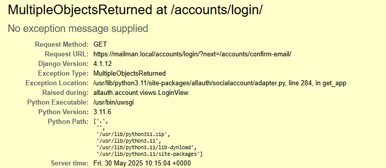

- Mailman currently only supports one OpenID provider at the same time. If you set up two or more providers, an error message about duplicate objects will be triggered ('MultipleObjectsReturned at /accounts/login/'). You need to remove (or comment out in
settings_local.py) all OpenID providers except for one.
