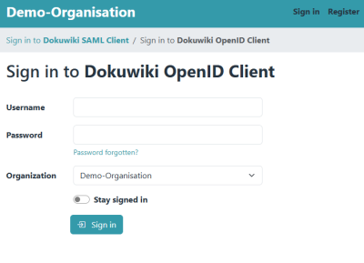

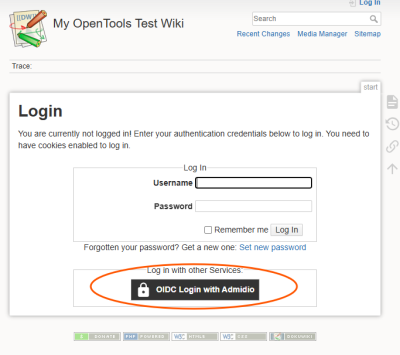

Admidio and MediaWiki should now be set up to use Admidio for logging in to MediaWiki. If you log out of MediaWiki and try to log in again, you will be shown the Admidio login screen and then redirected back to MediaWiki.

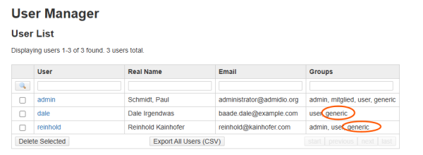

- MediaWiki controls login permissions for OpenID with a group 'generic' assigned to a user. If local accounts already exist, one needs to add them to the 'generic' group, otherwise login with OpenID is not possible and the following error message will be shown:
To fix this, add the user to the 'generic' group:
