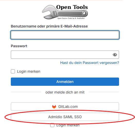

gitlab_rails['omniauth_auto_sign_in_with_provider'] = 'saml' # don't show gitlabs login screen at all

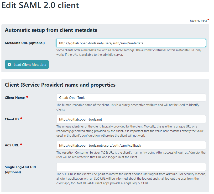

Gitlab provides its SAML SP client settings as a metadata XML at the URL
https://[GITLAB_SERVER_URL]/users/auth/saml/metadata
Paste that metadata URL into the corresponding input field at the top and click “Load Client Metadata”. This should load all settings from Gitlab and pre-fill the following fields correctly. Only the Client Name needs to be entered. Choose any name to clearly identify the client in the list of SAML clients. There is no functionality depending on the name.

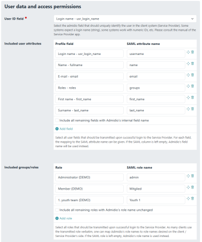

In addition to the Entity ID and URLs to connect SP and IdP and the certificate, which are configured automatically, one also needs to define the attribute and role mapping. The username is the most relevant and must match the uid_attribute configured in gitlab.rb. To use Admidio's group memberships as Gitlab groups, make sure to include the “Roles” field and provide the correct field name in Gitlab. Unfortunately, it seems that this features is only available in Gitlab EE (Enterprise Edition).
