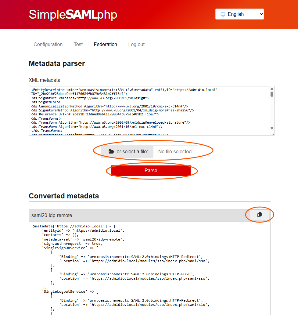

When SimpleSAMLphp is set up, log in to https://[YOUR_INSTALLATION]/simplesaml/module.php/admin/ using the password you assigned in the config/config.php file. SimpleSAMLphp can parse Admidio's IdP metadata XML file and produce a ready configuration that can be stored in the file metadata/saml20-idp-remote.php.
- Go to Admidio's SSO preferences at
https://[YOUR_INSTALLATION]/modules/preferences.php?panel=sso, download the SAML metadata file (direct URL is https://[YOUR_INSTALLATION]/modules/sso/index.php/saml/metadata) . - Go to the “Federation” tab and use the “XML to SimpleSAMLphp metadata converter” link to convert Admidio's metadata xml to a SimpleSAMLphp config. You can either past the xml content from the metadata file or directly upload the file itself. After clicking “Parse”, a config snippet for saml20-idp-remote.php will be shown, which can be copied to the clipboard with the “copy” icon on its top right. Simply paste the PHP structure into an empty file in a text editor and save it as

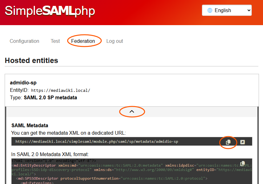

SimpleSAMLphp should now be set up to connect to Admidio. It provides metadata for automatic setup in the “Federation” tab in the “Hosted entities” section:
The link typically has the form https://[YOUR_INSTALLATION]/simplesaml/module.php/saml/sp/metadata/admidio-sp. Copy that URL to later paste it into Admidio.

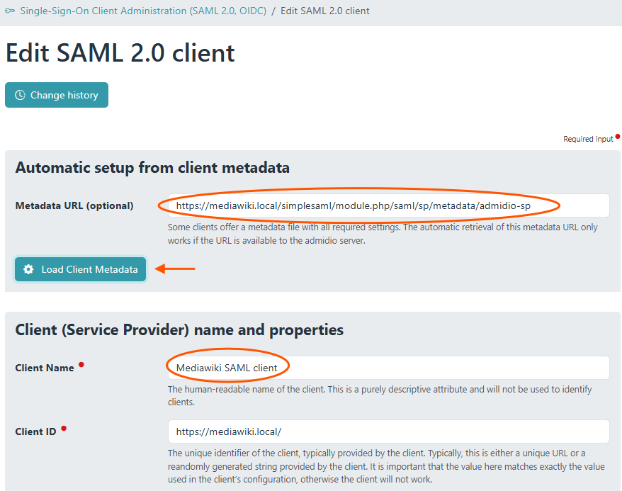

Now, return to Admidio's “Single-Sign-On Client Administration” (linked in the SSO preferences page, the button right above the “Save” button), and create a new client.
Paste the metadata URL copied from SimpleSAMLphp into the corresponding input field at the top and click “Load Client Metadata”. This should load all settings from SimpleSAMLphp and pre-fill the following fields correctly. Only the Client Name needs to be entered. Choose any name to clearly identify the client in the list of SAML clients. There is no functionality depending on the name.

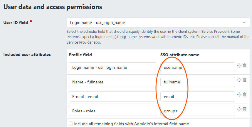

In addition to the Entity ID and URLs to connect SP and IdP and the certificate, which are configured automatically, one also needs to define the attribute and role mapping. The username, email and the fullname are the most relevant (and the only attributes directly used by MediaWiki). To use Admidio's group memberships as MediaWiki groups, also make sure to include the “Roles” field and provide the correct field name later in MediaWiki. Typically one would use “groups”.
To map Admidio groups/roles to MediaWiki groups, one can either use the group mapping of MediaWiki (which I have not been able to correctly set up), or provide the desired group names directly in Admidio. MediaWiki uses serveral internal group names to assign elevated permissions: 'sysop' for admin rights, 'suppress' for users that can block users and administrate page revisions, 'bureaucrat' to edit users, 'users' for normal users, 'bot' for bot processes, etc. One can assign admin or other elevated rights by mapping an Admidio role to one of those reserved role names (and later setting up the automatic group assignment in MediaWiki, see below):
One can also check the box to include all Admidio groups in the SAML assetion. This will cause Admidio to send all groups to MediaWiki. Groups that have no particular rights assigned will be assigned to the user but will not have any effect.

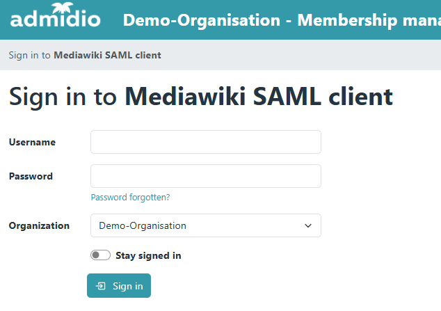

Admidio and SimpleSAMLphp should now be set up to use Admidio for logging in to SimpleSAMLphp. Switch back to the SimpleSAMLphp admin screen and go to the “Test” tab. Click on “admidio-sp” (the array key used in config/authsources.php for the Admidio IdP). You will be redirected to Admidio's login form.
After logging in with a user from Admidio, you should be logged in to SimpleSAMLphp.

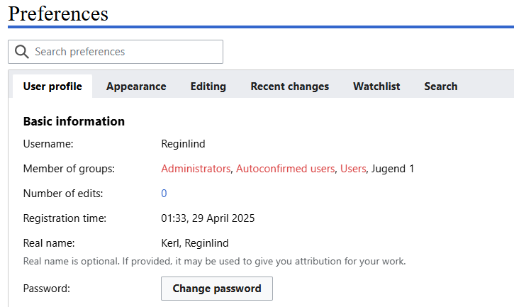

MediaWiki should now use the SAML login through the SimpleSAMLphp installation. Groups should be assigned as mapped in Admidio:
