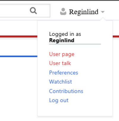

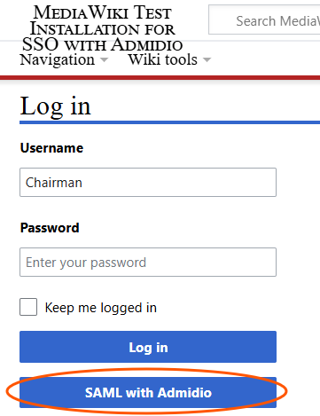

wfLoadExtension( 'PluggableAuth' ); wfLoadExtension( 'SimpleSAMLphp' ); # https://www.mediawiki.org/wiki/Extension:PluggableAuth # "The createaccount or autocreateaccount user rights must be granted to all users. " $wgGroupPermissions['*']['autocreateaccount'] = true; $wgGroupPermissions['*']['createaccount'] = true; $wgPluggableAuth_EnableLocalLogin = true; // Allow username/password login at MediaWiki $wgPluggableAuth_EnableAutoLogin = false; // $wgSimpleSAMLphp_InstallDir = '/var/simplesamlphp'; $wgPluggableAuth_Config["SAML with Admidio"] = [ 'plugin' => 'SimpleSAMLphp', 'data' => [ 'authSourceId' => 'admidio-sp', 'usernameAttribute' => 'username', 'realNameAttribute' => 'fullname', 'emailAttribute' => 'email' ], 'groupsyncs' => [ [ // There is also the 'mapped' type, but I have not been able to configure it! 'type' => 'syncall', // 'locallyManaged' => ['sysop'], 'locallyManaged' => [], // Default includes 'sysop' -> would never sync from SAML -> remove it! 'groupAttributeName' => 'groups', ] ] ];
MediaWiki should now use the SAML login through the SimpleSAMLphp installation.
